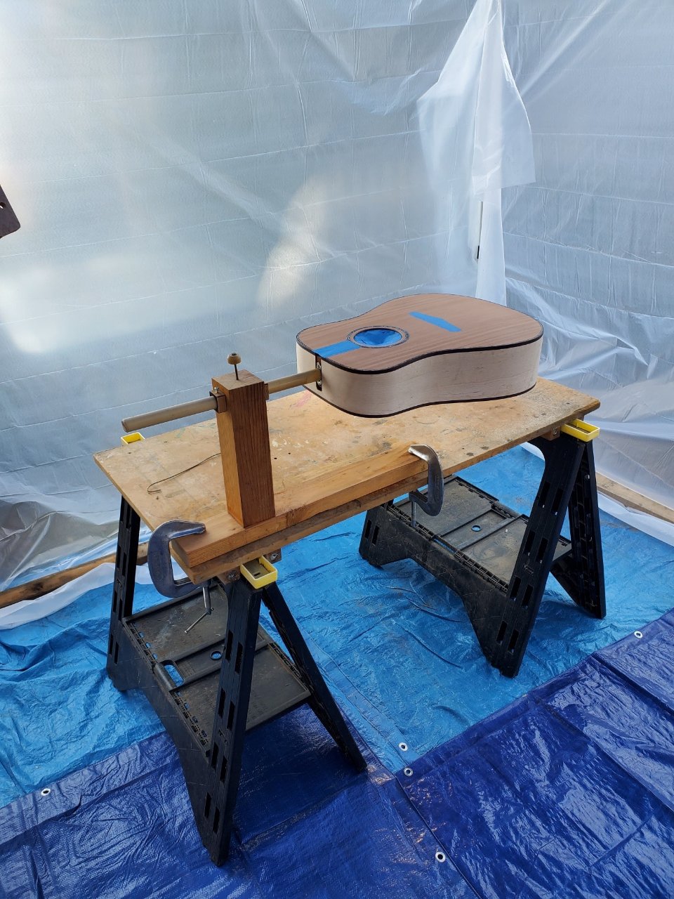

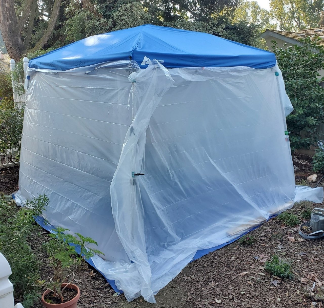

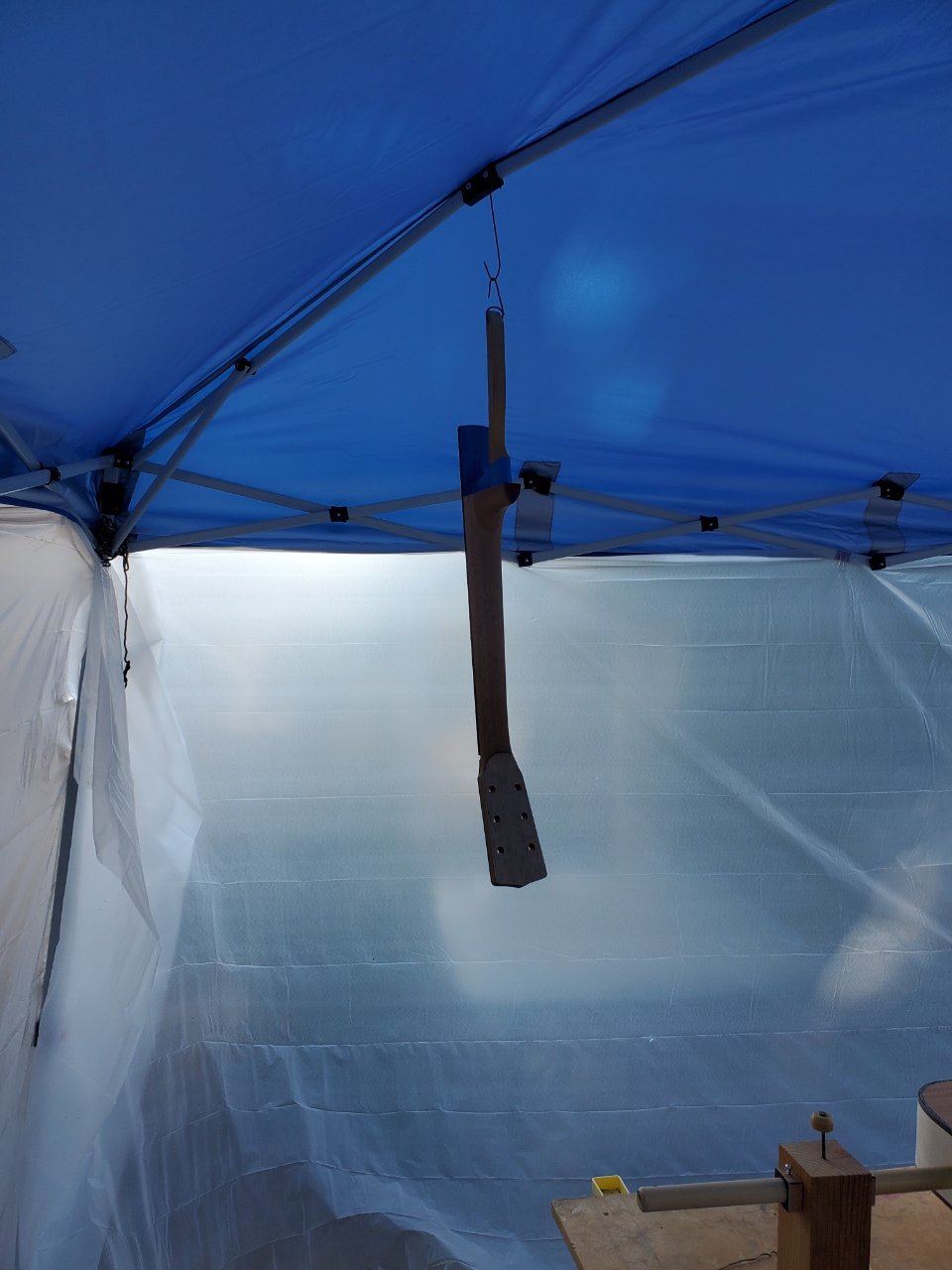

Okay so I got my new spray boot set up put up and it worked out great. For the last 10 years I've been using a wood knock down frame 6' x 6' x 7' tall wrapped in plastic and it worked out great too, but the frame parts was getting tired and weathered so I needed something new. about $50 total for this new one and easy to set up and take down.

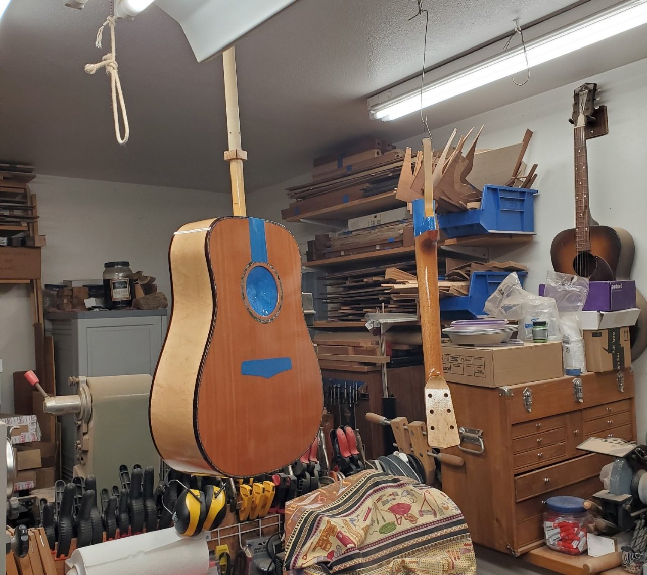

I was able to get two good coats of vinyl sealer and 4 coats of nitro lacquer sprayed. So far the guitar is looking good. What is usually exposed when the first few coats are sprayed are littlt gaps here and there, and so it goes with this one. I tried SO HARD to get all these before spraying. Mostly there are some small low areas in my abalone purfling. Again I tried and thought I had this all filled and leveled, but I do see some low areas where the lacquer sunk in so I'll take care of those this week before the next spraying session. I can do that for 3 weeks which is a shame but this coming weekend, too cold and raining, and the following weekend I'm out of town. Oh well.
I might level the finish before spraying again since it will have some cure time. My plan is to spray 8 more coats, but I may stop at 6 if all looks well. I always have to level after the last session anyway. I've never been able to get a smooth level end result. It must take lots of practice. This is my 12th guitar spraying lacquer.
So here it is in the booth and hanging in the shop after.
