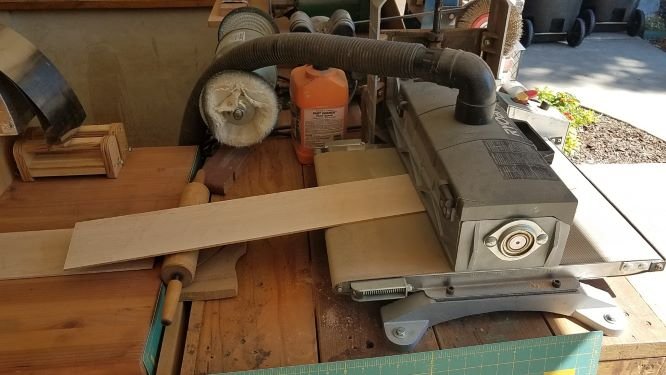

So I was able to thickness the maple sides on my drum sander. This takes awhile because they started out at 3/16" thick and I took them down to .080", but it still works well.
I have a safety planer for the drill press for thinning them down, but maple can be kind of chippy so I didn't want to risk messing them up.

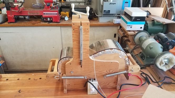

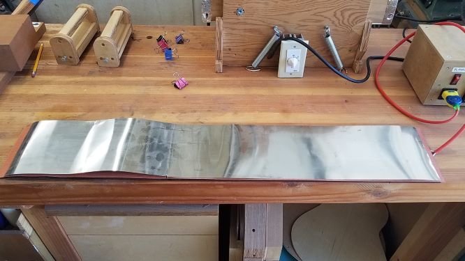

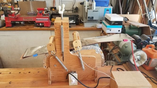

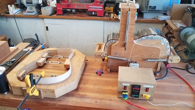

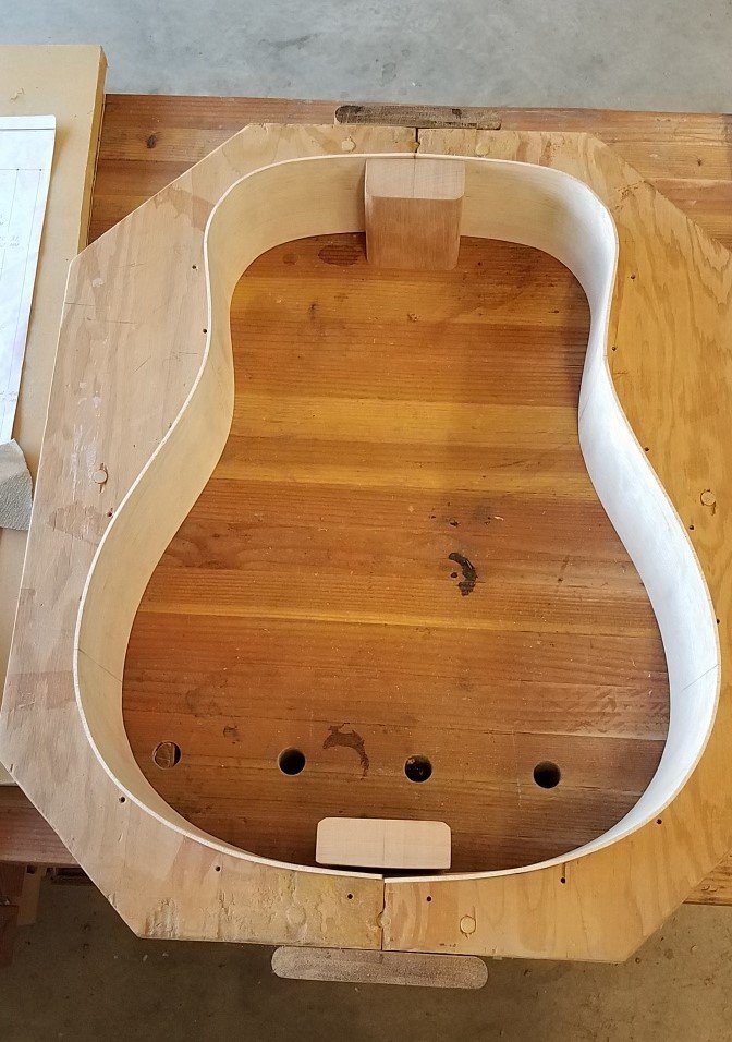

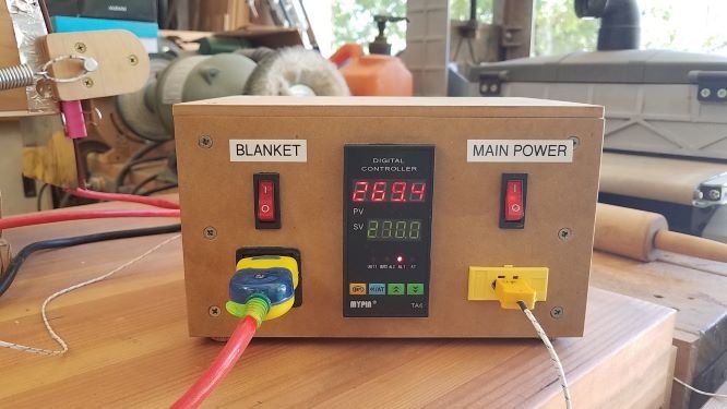

The side bending went perfectly. My bender has 3 x 150 watt lightbulbs in it that will heat up to over 300 degrees, but the blanket and controller I started using about 5 years ago work so well. The whole bending process once the sides are setting in the bender takes about 5 minutes from start to finish of the bend. I start bending the waist at about 220 and by the time the temp is up to 250 the waist is almost done. I leave a little bit to bend after I've done the lower bout so the side pulls down a bit tighter around that curve. By the time the heat is up to 270, both bouts are done. I let the side cook for only about 5 minutes, then cool it down. At 100 I took the sides out and clamped them in the mold.
No cracks, no scorching, near perfect bends. That is how its supposed to be right!

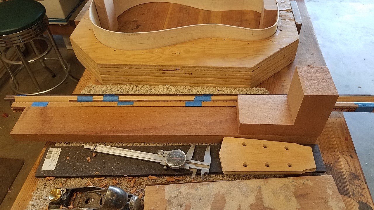

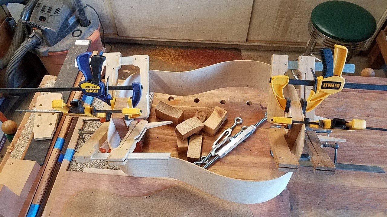

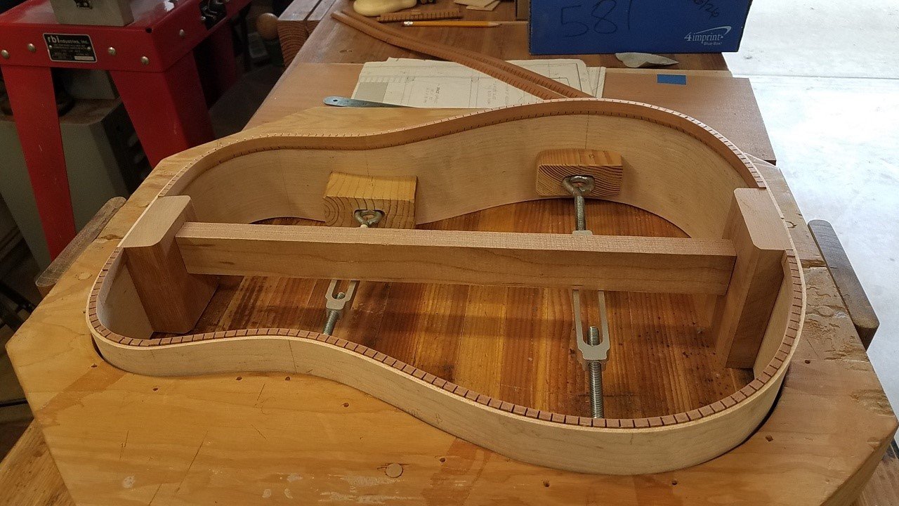

Made a little progress this past Saturday. I got the sides trimmed to length, made the end and neck blocks and glued them in. The neck block was cut from the extra large mahogany neck heel block that will be used for the neck.

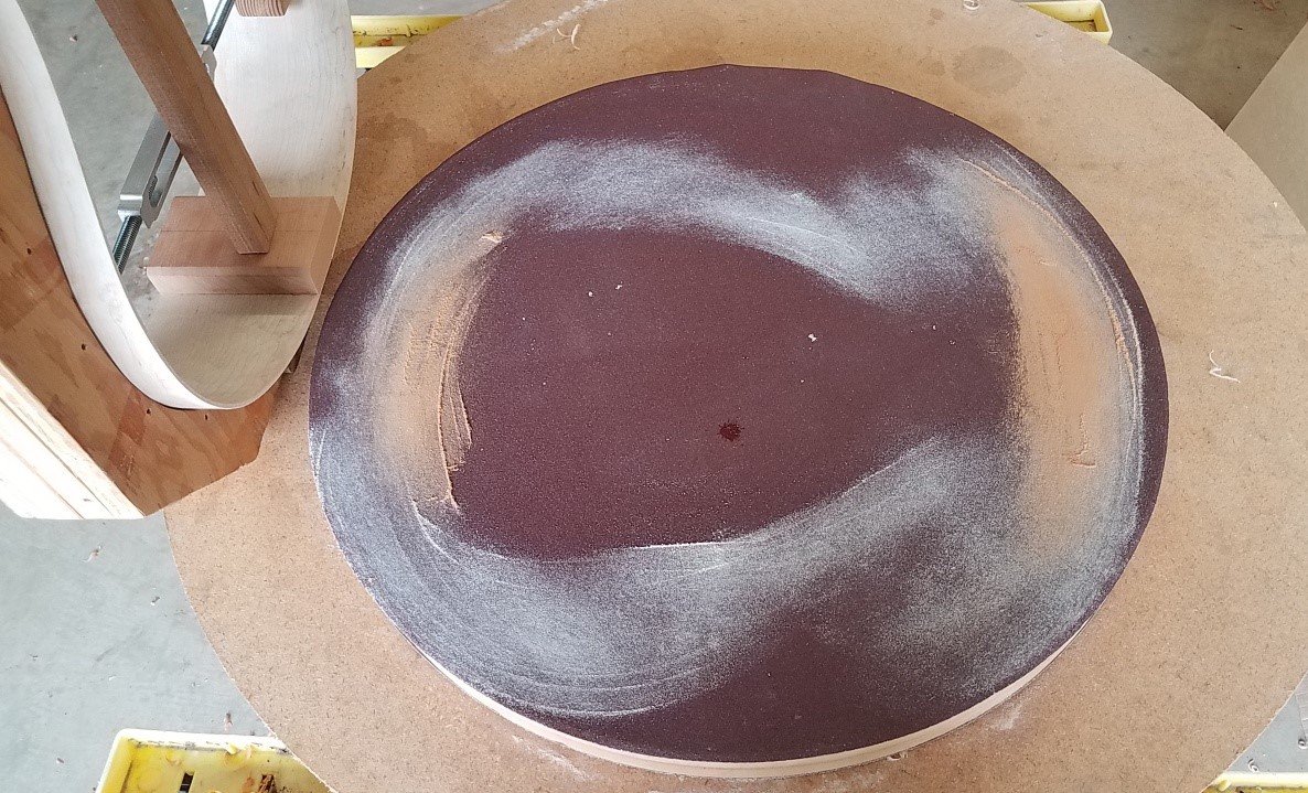

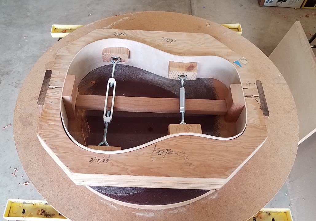

I radiused both sides in my double sided radius dish. 15' radius for the back, 30' for the top. You can see the saw dust on the radius dish which indicates when you have all surfaces sanded, this along with some chalk marking the edges insures a uniform edge

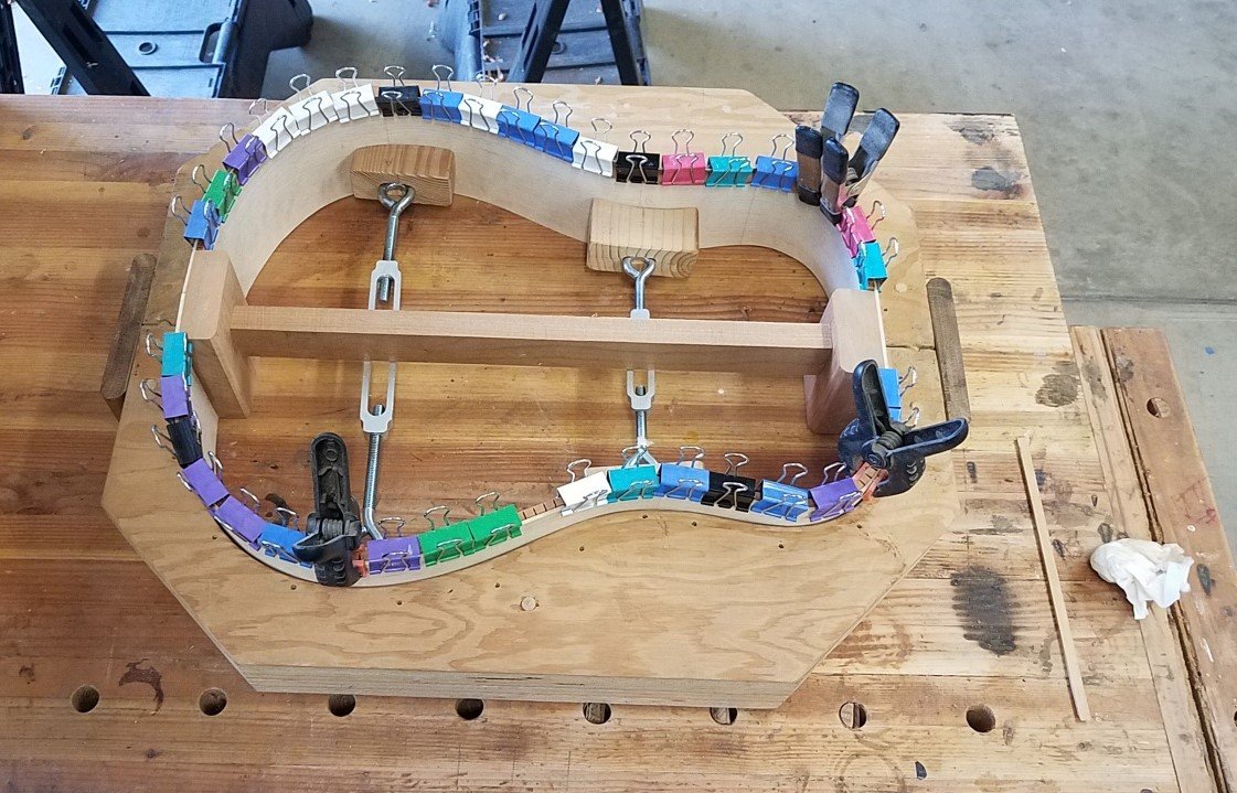

Then I glued in some reversed kerfing on the back of the sides.
This was the first time I've used reversed kerfing, and I was not impressed. The webbing was so thin the strips broke in multiple places no matter how carefully I handled it. I will probably not use this stuff again. Anyway, for the last few guitars I've used my own made kerfing so I think I'll go back to doing that on my future guitars
Next step will be to glue the kerfing on the top edge, and re-radius the top and back in the dish. This goes quickly as the mahogany sands very easliy.

Kevin, I've used reversed kerfing on four guitars (in other words, all of them so far) and I found that the stuff I got from Grizzly broke up in transit even before it got to me. Busted out of the box. Stuff I bought from RC Tonewoods had a thicker web and I've had no problems. I did use some of the Grizzly stuff, I laminated a reinforcement strip on top of the entire kerfing, reminiscent of binding, but inside. That worked for me. I enjoyed making rims with a lot of inherent stiffness.
Re: FINALLY I am starting another build after 2 years off.
Peter this kerfing came from LMI. Not knocking them, I love their stuff, but these strips are not very good. I will go back to the standard style.
