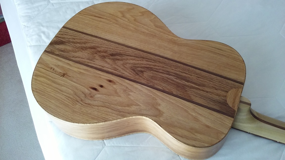

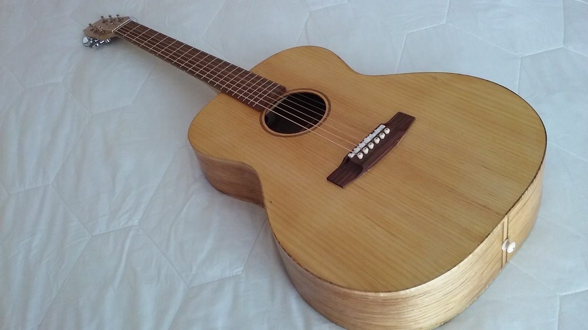

Number 7 guitar is black ash, a variation I was unaware of; was familiar with white. It was a board in among some rough-sawn red oak short pieces I had. The sawmill guys told me what it was, see: viewtopic.php?f=32&t=3183
I pieced in a central red oak panel with .25” walnut strips as dividers for the back, as I didn't have enough of the ash to complete that part. The end graft is red oak with teak strips.

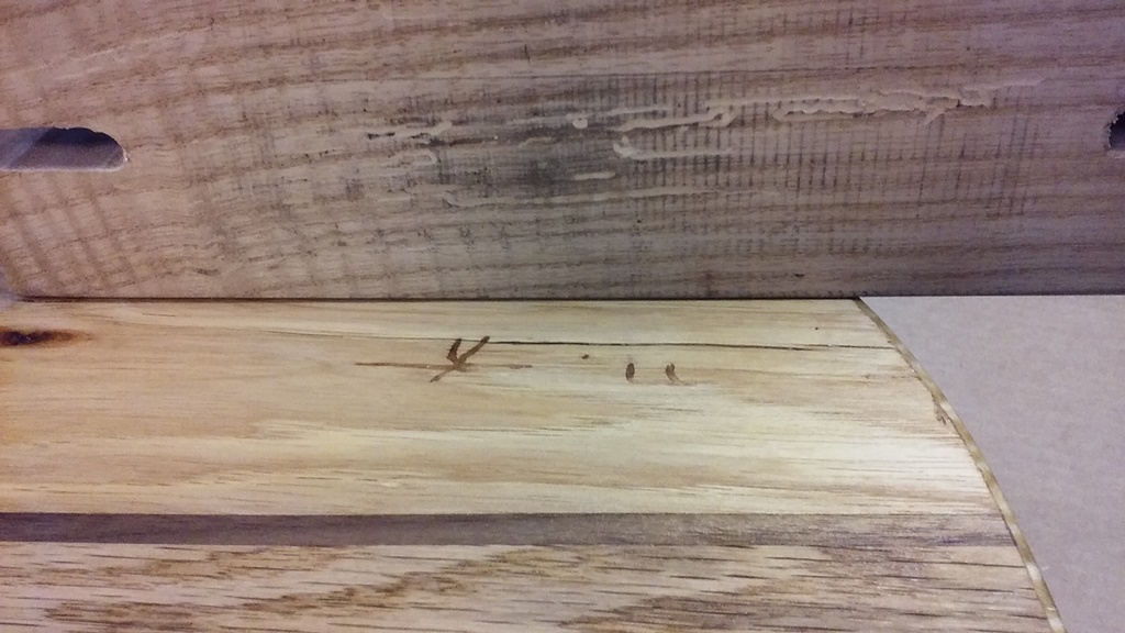

Planing the back to thickness on Dewayne's splendid Powermatic drum sander with digital controls uncovered borer tunnels that look similar to a white ash piece I use as a clamp with my homemade Fox bender (photo) but the sawmill guys say that they aren't the dreaded Emerald Ash Borers as they only eat the cambium layer. Same destruction, though. In my lifetime we've lost elm, chestnut, and now ash trees.

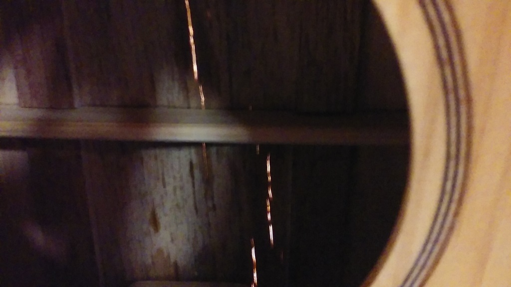

I put the body together in the summer, humidity in the farm shop, but the back cracked when I started the pellet stove in November, mostly in the central oak panel. Glued the cracks with cyanoacrylate but looking in through the sound hole it looks like a a dry cedar shingle roof from the attic (photo).

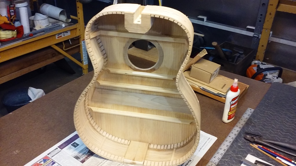

This was an unlikely candidate for an actual soundboard. It had quarter-sawn grain where joined in the center, but ran out to what could barely be construed as rift-sawn at the sides, and the grain lines were miles apart there. It was somewhat stiff longitudinally but just limp, really floppy-loppy, transversely. It also has a nail hole near the binding in the lower bout on the bass side. But it seemed like the lack of transverse stiffness just cried for a ladder-bracing scheme, and I hated to waste the construction effort.

This time I lengthened the maple bridge plate under the sound board and added a brace.
I make my soundboard bracing exclusively out of white pine, as Don Teeter said in his first book that he'd once used it for that purpose with excellent results. In addition, I can usually find vertical grain like quarter-sawed easily in most #2 common white pine boards.

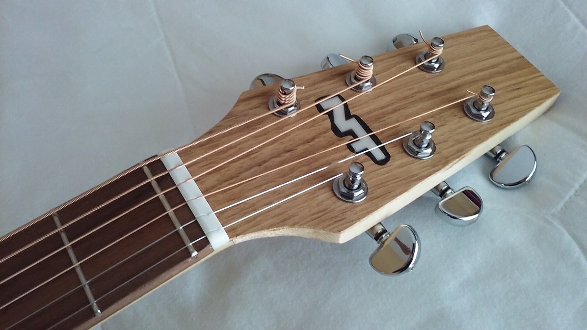

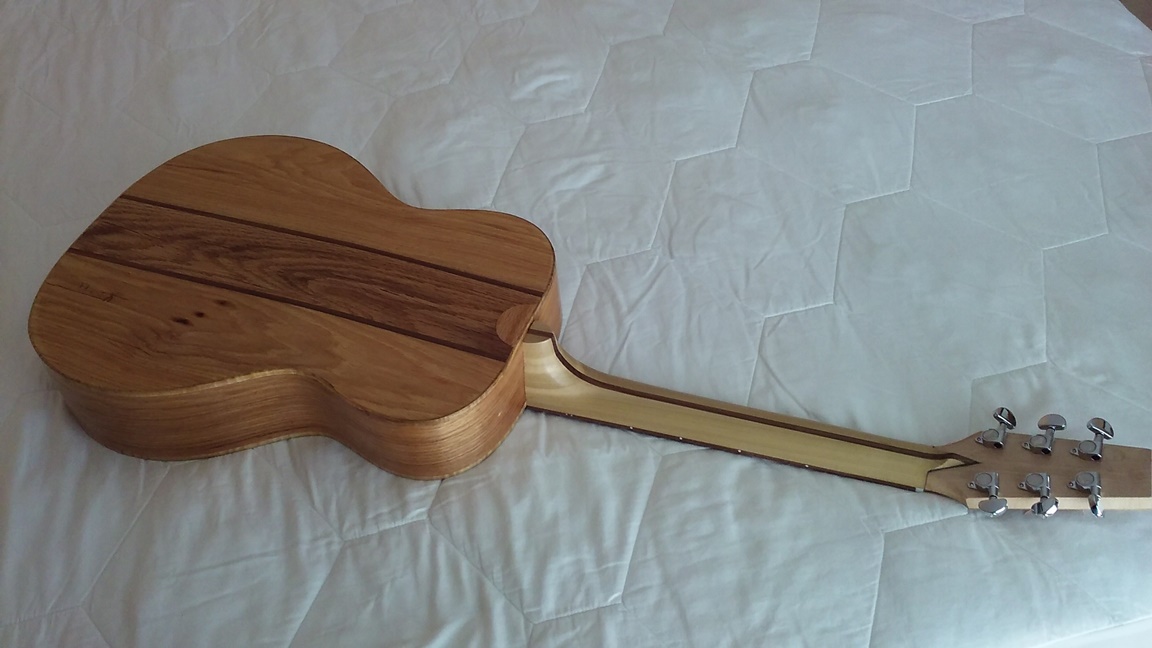

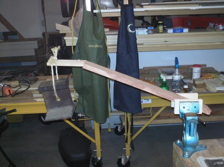

The neck is yellow poplar with a .25" walnut center stripe, double-action truss rod. The headstock is hard maple with a veneer of black ash, attached with JB Weld at a version of a Spanish Vee joint. The JB Weld's gray color here is visible (and looks messy on this one) but it's lots stronger than Titebond. Discovered this after accidently knockng a prior neck off my router table and the Titebond, with an obviously less than close fit, popped the headstock off, although it had withstood my "railroad track" test (photo).
Back on #5 I used my old Sears router and an 1/8” bit to successfully inlay my mother-of-pearl NT logo in a quarter-sawed sycamore veneered headstock. Then I had cataracts removed that resulted in double vision. Borrowed David's Dremel with StewMac router base, still couldn't manage to successfully do that for #6, so got some black dye and made a surround for the mother-of-pearl with clear epoxy, which I again did on this one. Couldn't find the MOP so spent an afternoon making the NT out of Corian, then went looking for the bits and found the MOP. Used the Corian logo. Second operation this last October finally cured my double vision.

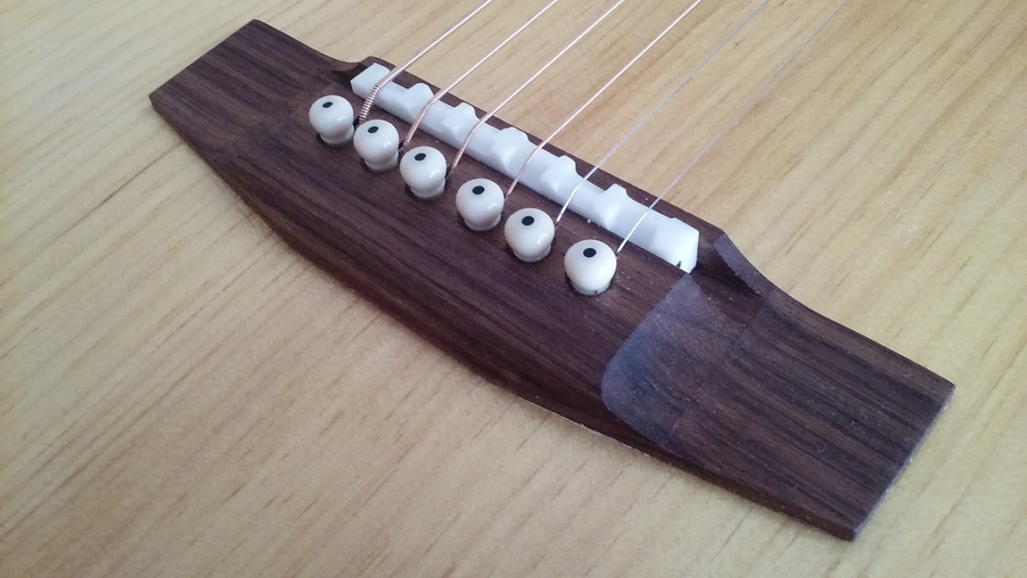

The fretboard and bridge are (plain-sawn) walnut, per the old Acosta guitars made in San Antonio where my son-in-law is from. 25.4” scale, 14 fret guitar, OM body. No end block on the heel of the neck. Zero fret is StewMac #0152, .009” higher than the #0148 frets.
My luthier friend here, Kjell, has done some ukuleles and mandolins using garnet shellac, which makes for a splendid, dark, aged look as a finish. I don't build fast enough to use up 3# of shellac flakes, so went looking for alcohol-based dyes, couldn't find any locally. Substituted some orange alcohol-based ink, which I mixed in the Zinser Seal Coat that I use two coats of to start, in order to give it an older “orange shellac” look under the two finish coats of satin wiping polyurethane.
Wonder of wonders, after all the trials and tribulations I had with two different necks and bridges on #6, my original angle selection for the neck of #7 worked fine and the projected bridge height was within 1/32” of the build height.
The neck attaches with two K-D fasteners. The (false) nut and 1/4” saddle are Corian from a sink cut-out, a lifetime supply. Nut and saddle are not glued, though closely fit, so easily removable. Neither is the fretboard extension glued; I want the soundhole end 1/32” high before stringing up, and the string tension pulls it down flush, no rattles.
Strung it up yesterday. Sound file maybe next week. First pass at setup left low E clearance at fret 12 higher than I like, after concert pitch string tension put the wood where it wanted. I always think the bass is too weak when I first string one up, but by next week it'll be fine, sounding better already. Treble is nice and bright.
