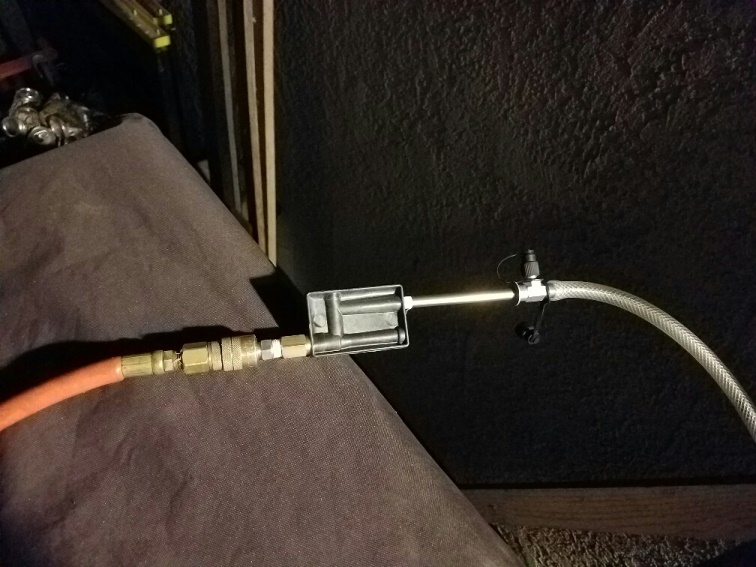

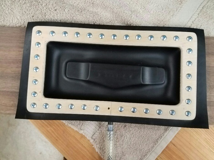

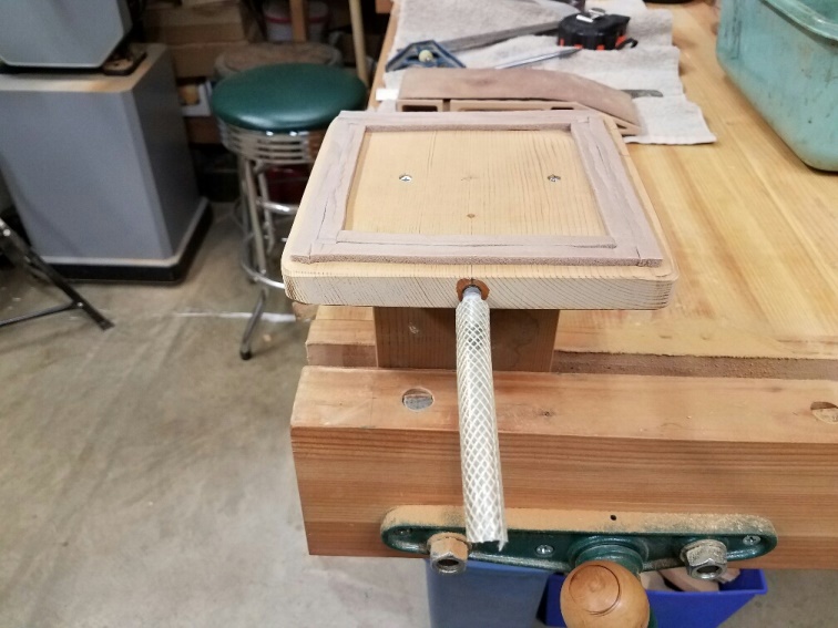

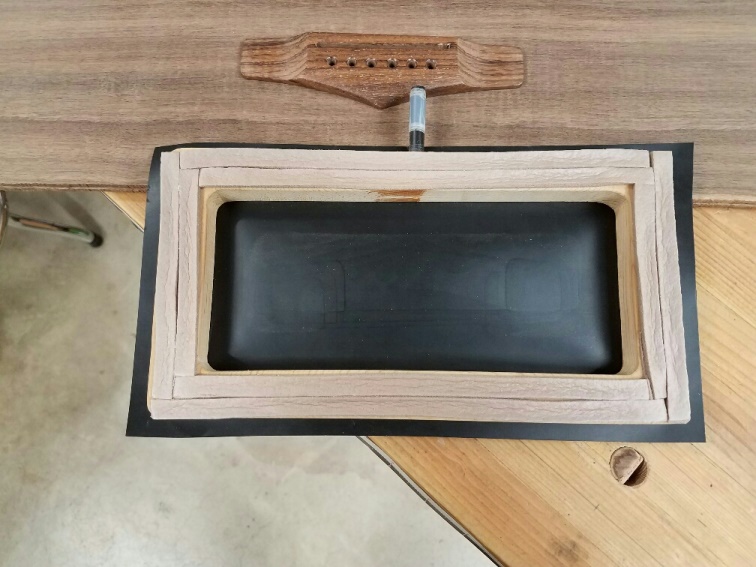

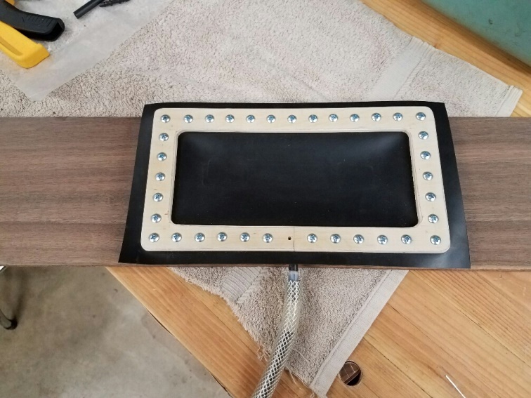

I never new I could get this set up for so little $$$$$$. The venturi vacuum generator cost $18 at Harbor Freight. Guys, if you want to do this and you all ready own an air compressor, then this is an effective and super inexpensive way to get your vacuum
The clamp is made from yellow pine for the base, 1/4 plywood for the bezel, #8 by 3/4" sheet metal screws and the 1/32" neoprene sheet. The wood I already had. The fittings from the vacuum generator to the clamp are all from my drip irrigation parts stash, and a couple of pieces of larger poly tubing.
And some 3/8" x 3/16" closed cell door insulation foam. Total cost to make the bridge clamp, about $6.00. So I have a set up for under $25. It is not heavy duty, but since I only glue on about 2 bridges a year, I figure I'm good to go. The foam is cheap if I need to replace it after a couple uses.

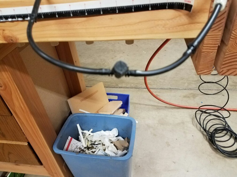

The venturi exhaust is very loud, so I put it outside my shop, the door outside is right next to my compressor, and ran the drip line tubing, about 20 feet to the bench, and no problemo, still got vacuum and the noise was now outside. My compressor has a 27 gallon tank and within a few minutes, it kicks on, but that is okay. I am happy! I also made up a quick clamp for the body of the guitar. I can put in my vise and hold the guitar horizontal, or reclamp in the vise on the end, and hold the guitar with the sides up. I forgot to take a picture, but it worked great, and it cost me next to nothing! I''ll fix it up so it is more sturdy and secure, but there you go. Both clamping fixtures and a vacuum pump for about $25.
