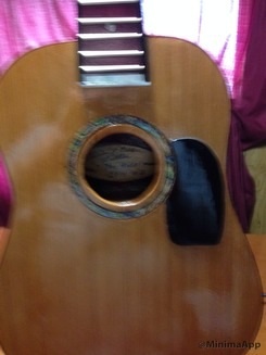

Well I've made some boo-boo's. But maybe I'll get better.
Re: For any wipe-on oil finish
Ok I hope this posts. That's my belly reflected in the finish. Lol
- image.jpg (20.92 KiB) Viewed 11874 times

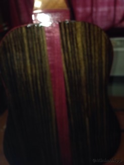

Here's the back. I have another one started for another neighborhood girl.
- image.jpg (14.54 KiB) Viewed 11872 times

Looks real good to me, Lonnie. She's gonna love it!
