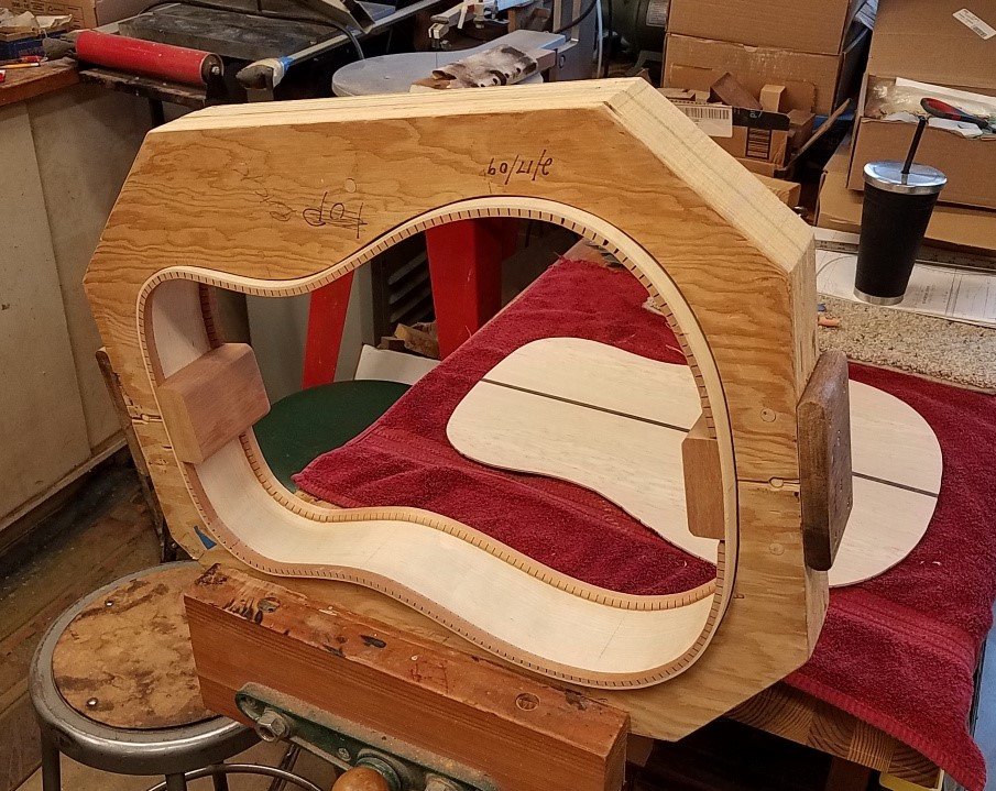

This weekend I was able to get the rest of the kerfing installed and the rims re-radiused on the radius disc.

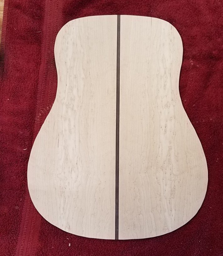

I also got the back plates thicknessed and joined with a 1/4" wide east indian rosewood center strip. This will match the EIR bindings.

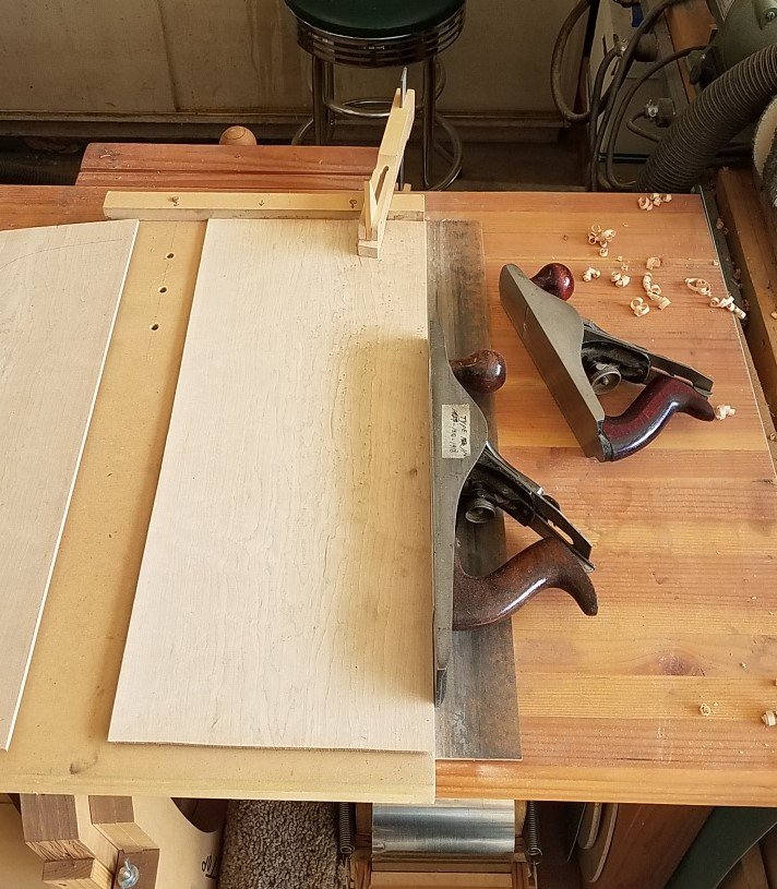

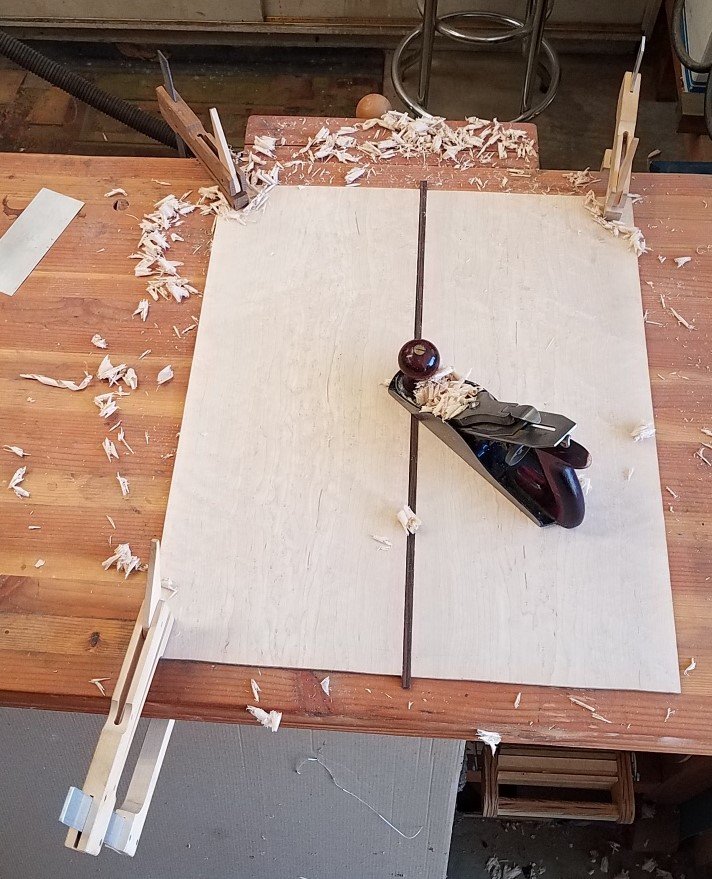

Anyway, so I got out my hand plane and took the back plates down from .0170" to .0110 with the plane and RO sander. No picture of this but I used my #3 Fulton plane made in the 1930's to do this. Made a big pile of shavings on the floor. I forgot to take a picture of this step. The back looks good.

Hey Kevin.`
That looks good. But why do you use such a massive mold? You'll get yourself a hernia.

Re: FINALLY I am starting another build after 2 years off.
That's a BEAUTIFUL mold. Ain't gonna move nowhere.
Ha ha Herman,
That was the first mold I made. Believe me, the next two were made much lighter.
This one is heavy, and its also not super accurate. I've built, lets see, 7 dreds with this mold.
When I retire, I think I will make a new dred mold and ship this one to Holland for this guy I know who builds guitars there.

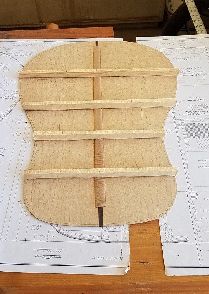

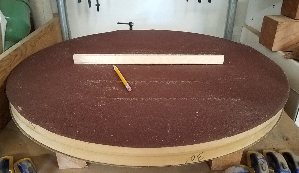

Then I cut some spruce bracing stock and got the back braces made and radiused. I use my double sided radius dish to sand the radius onto the bottom of each brace after tracing the approximate shape with the brace setting in the dish, then rough cutting on the bandsaw.
That's as far as I got this past weekend. Not too exciting, but just a step in the process.
