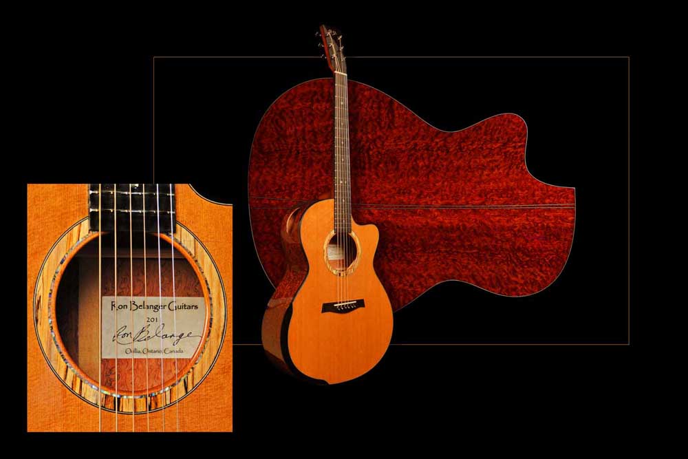

Well I love that guitar pictured there. I bought a set of Bubinga back and sides. Not real highly figured so hopefully it will bend ok. Crossing my fingers anyway

Bubinga is a terrific tonewood and can be anything from plain Jane to stunning visually. Tonally it is excellent. I have had no serious problem bending the sides thinned to .080 or a little less and some Supersoft II. The only issue is that the highly figured pommele set I used as well as some of the plain grain has a tendency to crack if the humidity is even slightly less than 40%. I have 4 cracks in the back of the one pictured here to deal with. All in the lower bout right near the bottom. Difficult to get to.
