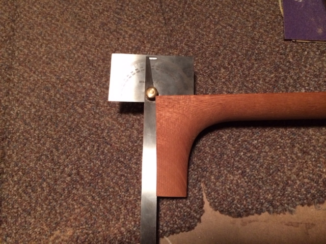

ken cierp wrote:You need to flip the protractor the other way so the long part lays along the "cheek" of the heel --- not next to the tenon. that is the angle which is important, where the heel contacts the body -- I bet its 88.5 +/-
Ahhh, so not along the fingerboard side like I have it in the picture. Okay, I'll
do that tonight. It should be 88.5 cause it's straight from Martin. So, 88.5+91.5= 180degs.
That should do it....

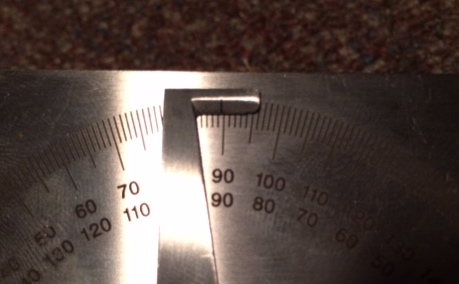

Okay, so i took the protractor and flipped it around so that
the long side is on the cheek of the neck. In the close up picture
you can see that it's reading between 89 and 90deg. Am I reading
it right this time? I think i am.
I'm assuming that I'm supposed to be using the top row of
numbers now since I flipped the protractor over. Is that correct?
Re: Neck angle second chance.....
Post by Tim Benware » Thu Oct 03, 2013 12:01 am
I would say yes.

Post by MarkAndrew1 » Thu Oct 03, 2013 9:12 am
So, if it's reading between 89 and 90 deg's should I base it on the 89?
If I do that then the complimentary body angle would be 91deg to form
the straight line. Am I on track here?
I don't want to move forward until I'm positive that's correct....
Post by Tim Benware » Thu Oct 03, 2013 9:42 am
Yes.
