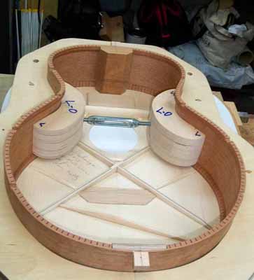

It is the L-O plan and I used an X brace. The plan calls for 12 frets to the body, but the customer wanted 13 and I like the look of the 13 as well, particularly for that short scale length. As far as sound goes, this guitar has got great resonance and volume and is well balanced low to high with very good mids.

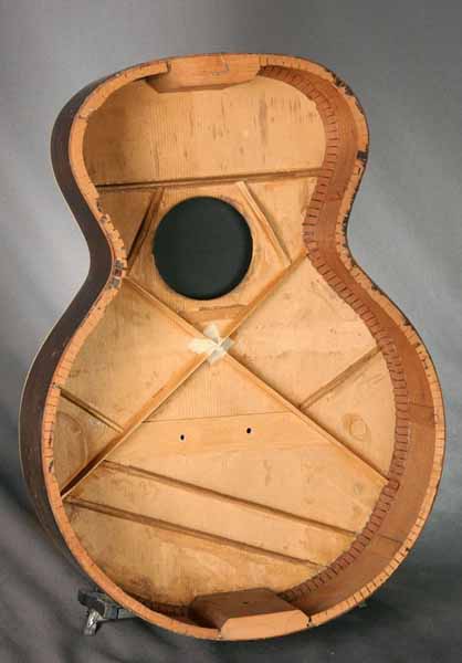

I based the bracing on the Gibson 1929 L-1 bracing. The first thing I do when starting a new model is deciding on the scale length, then I determined the saddle position for the 24.25 inch scale length and adjust the arms, or shift the x to cover the corners of the bridge. The x angle is about 97 degrees. I used a single tone bar and single finger braces. Light gauge strings only.

Thanks for the info, looks from the picture like you used a considerably heavier shoulder brace, must be very responsive with the single tone bar and real easy on the fingers with the short scale.
