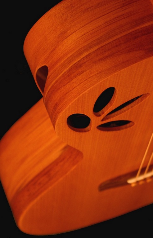

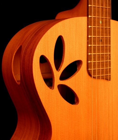

Here is what can be accomplished with no binding - not mine, I could not yet pull it off - this guy bevels the plates and the rim to get this ultra clean look. I'd really like to see his set-up, which must be really precise.
- 7kauri.jpg (47.5 KiB) Viewed 2856 times
- 8kauri.jpg (72.68 KiB) Viewed 2856 times
