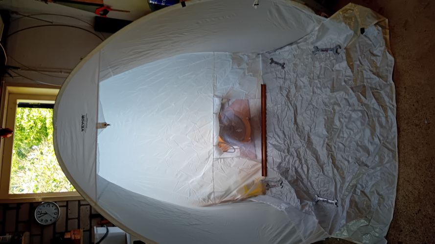

This is what I bought:

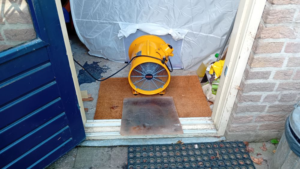

1. A spray tent of about 6 x 6. for 30 bucks.
2. It has an opening on the back and for the airflow I bought a spark free ventilator (180 bucks)
It works so good that a mask is hardly needed.
And when ready spraying the ventilator goes under the bench and the tent goes folded in a small bag.
I'm happy.
