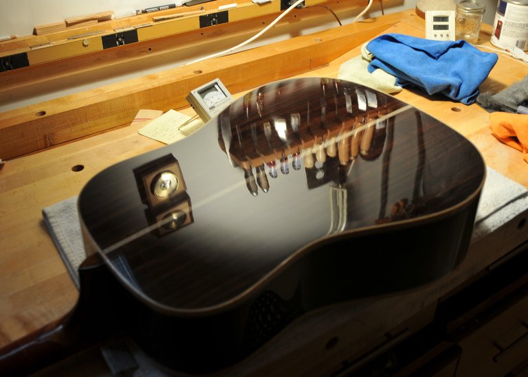

On my KMG HD-28 I used Menzerna's polishing compounds. If memory serves, I applied it by hand first in a circular pattern and then with the grain, moving through the grades from coarse to medium to fine (different cloth each time of course!) and then a final polish with their liquid. This was the result.
HD-28 017.JPG (81.84 KiB) Viewed 9559 times
