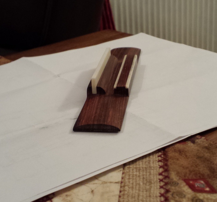

Completed the bridge last night, except for drilling the string holes. The outside bone strip on the tie block picked up some oil or something and is stained. I isn't scraping, sanding, or wiping off with acetone :( so I will probably rout it off and glue on a new one. I don't like the look.
But I'm pretty happy with the way it turned out for my first classical bridge.

Post by John Parchem » Wed Oct 22, 2014 11:33 am
The bridge looks great!
What did you use to glue on the bone. I would un-glue it before routing it off. Acetone if CA a little heat if it is a PVA glue. I am always nervous using the router when I am fixing things.
Post by Kevin in California » Wed Oct 22, 2014 11:44 am
John I will clamp the bridge in the cross vise on the drill press and use a 1/8" end mill. Works great and is precise enough and I'll have a nice new crisp slot for the new bone. This is the way I put in my saddle slots too.
John, when you built your classicals, did you make your bridges? I rather enjoyed the process.
