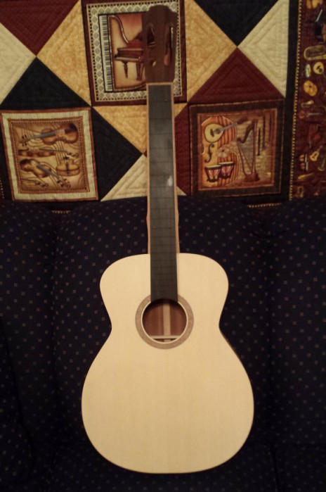

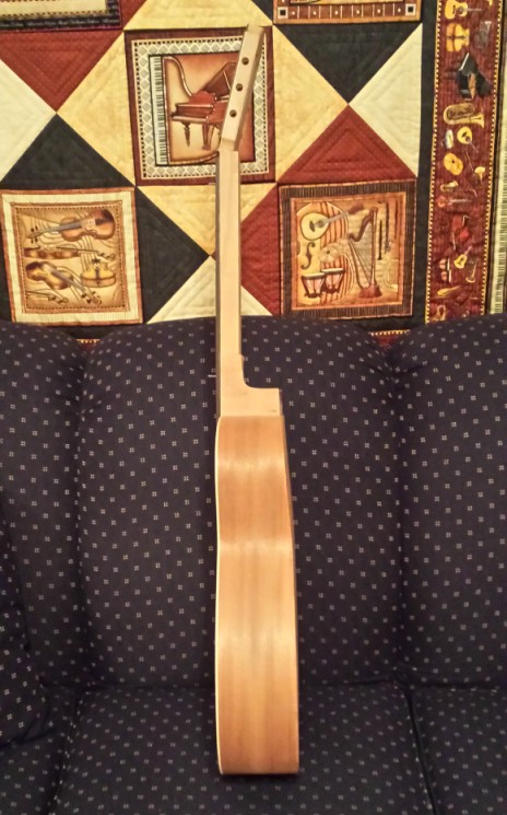

Post by Kevin in California » Wed Sep 10, 2014 2:10 pm
Box is closed, sides sanded level. Side to top at the neck is a flat 90 degrees. Next step is to rout the mortise, and put the tenon on the neck heel and see how the geometry looks. The box is nice. Sounds like a drum! I like the look of the Sapele.

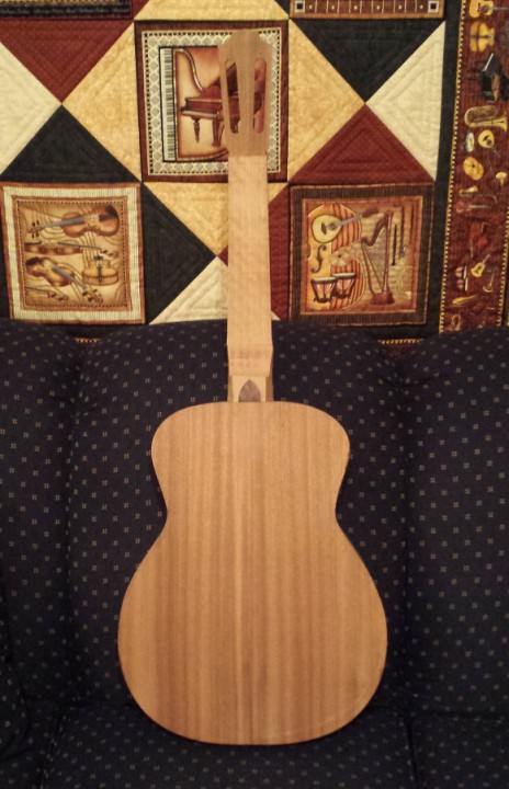

Post by Kevin in California » Mon Sep 15, 2014 9:48 am
Neck is fit to the guitar, not yet a perfect fit, there will be some adjustment to do there, bolt on mortise and tenon. Fretboard is made and located on the neck. So far all is good. Next is to bind the body and shape the heel.

Post by Lonnie B » Mon Sep 15, 2014 10:18 am
Looking good Kevin. I love the side profile.
