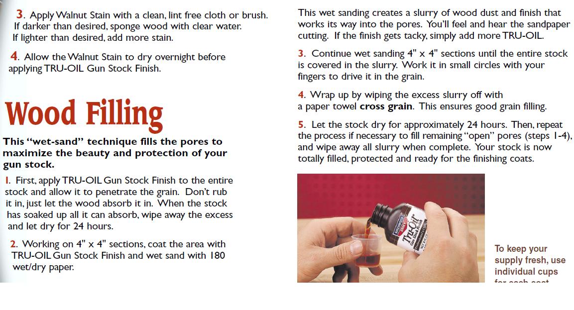

Hello Guys, Can I pore fill the mahogany neck with z-poxy then sand, then apply a rubbed on Tru Oil finish??? Thanks Jack.
Re: Steel wool and other hints
I'm pretty sure that will work, but I've emailed Birchwood-Casey to make sure and will report back asap.
Thanks for the Help!! Jack.
From the company:
Dear Dave,
Thank you for your inquiry.
The Tru-Oil will work over the epoxy, but it will not be as durable of a finish. In fact, it might scratch off easily.
The Tru-Oil really needs to absorb into the wood for best results.
You can fill the pores with the Tru-Oil. ( Using the wet-dry sandpaper)
I have attached our refinishing guide for further instruction on the wood filling with the Tru-Oil.
If you have any additional questions, let me know.
Thank you,
Sandy Ellertson | Birchwood Casey LLC
I attach a screen shot of the refinishing guide she sent me.
Dear Dave,
Thank you,

I already have the neck pore filled and sanded smooth with z-poxy ready for a finish, Any recomendations ? Wipe on Poly? Or should I just go ahead with the Tru oil and take a chance? Thanks for your help. Jack
