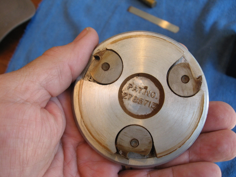

I have read somewhere that the copy can kick back because the plate is slightly different, just a word of caution as I have no first-hand knowledge.
Re: My new Wagner Safe-T-Planer Setup...
I've experienced no kick back with mine, cuts smoothly, but you can't take a big bite at a time, I'm sure its the same with the wagner
I think what I read was that it had to do with the "Woodworker" model having cavities on the bottom that can fill up with debris and the Safe-t-Planer is solid.Kevininca wrote:I've experienced no kick back with mine, cuts smoothly, but you can't take a big bite at a time, I'm sure its the same with the wagner
(Looks like I gotta clean that thang. Just finished thinning some Braz rosewood the other day, that stuff is hard.)
I used to have the original Wagner until it was loaned out and never returned. Have since been using the Woodtek knockoff.
I am very satisfied with the performance of the Woodtek, and the only performance difference I have noticed is that the cutters seem to require sharpening on a more frequent basis.
But then again, this type of comparison could be very subjective, as I have used the Woodtek on both Lignum vitae and African blackwood, whereas I never had the opportunity to use the Wagner on such woods.
Keep the cutters sharp, and keep the tool spinning as fast as your drill press allows (up to max recommended speed), and you'll be a happy camper.
Not a bad idea to invest in an extra set of cutters. Saves a lot of time during the project by simply switching out cutters instead of stopping to clean/sharpen in the middle of everything. The dirty cutters can be soaking while you're still working.
Always have plenty of sandpaper; it's rough out there!
