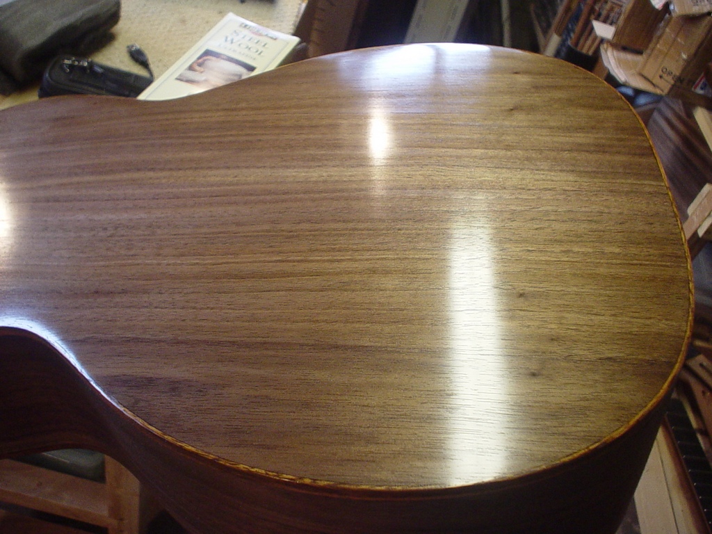

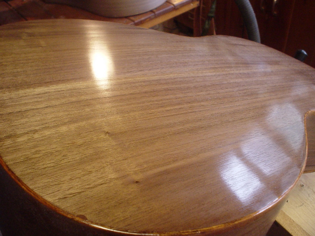

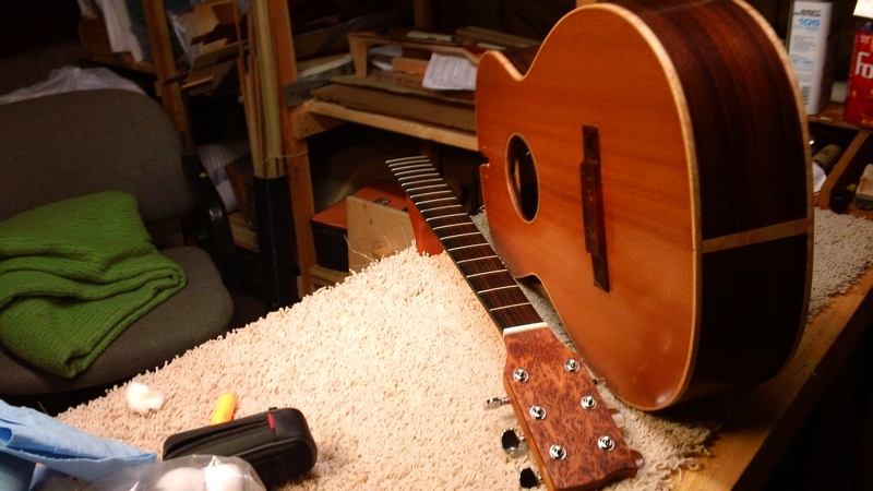

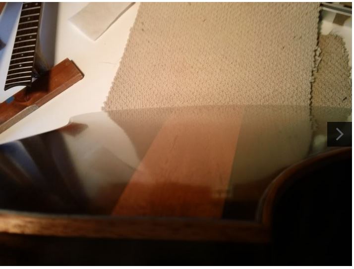

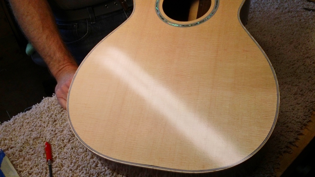

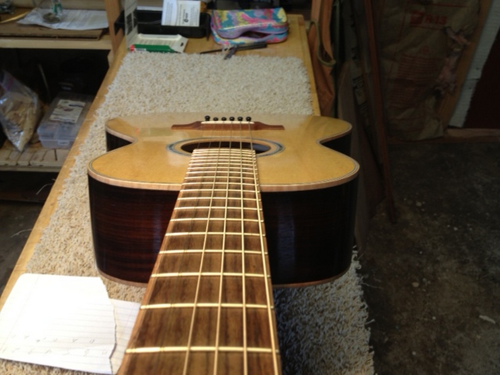

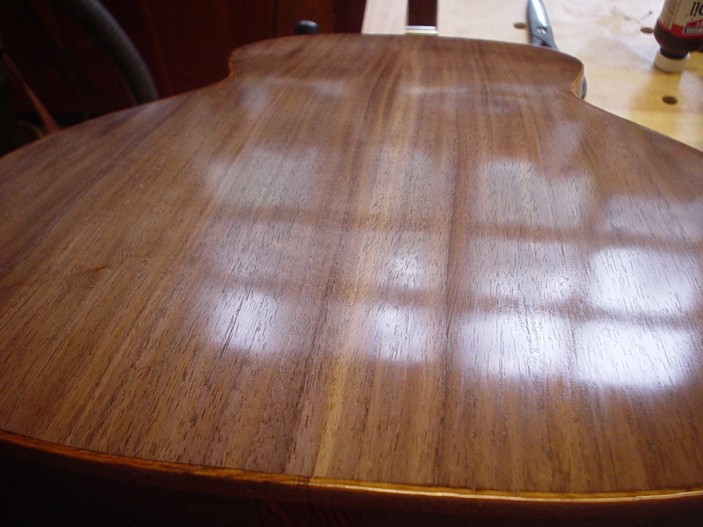

Dave do you have any pictures of any acoustic guitars you have done? I would love to see some of your work. You sound like you have this Tru-Oil thing down real good.
Re: Tru_Oil Question
Here are a few. There are varying degrees of gloss, and that's a matter of taste. I do like the ultra shiny finish but as a rule I prefer a 'hand-rubbed' look and my students have liked it as well. The first picture below shows the shiniest of the one's I've built, but that's as far as I go, and most of the time do enough finish to bring out the warmth of the wood and leave it at that.
You can take TO up to super gloss if you follow the directions.
