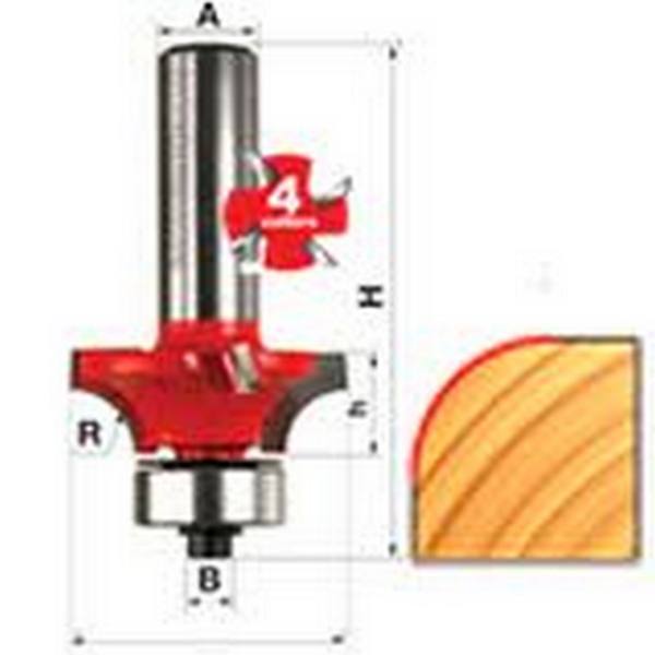

Would this be a good way to get a good consistent bevel?

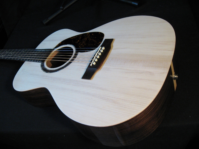

I don't see why that wouldn't work with the right radius. I just hand sand mine. Here's one of the latest I did.

Post by Dave Bagwill » Fri Nov 09, 2012 12:58 am
Looks real good to me. I admit to being a little worried about a router that close to a finished body..
Re: Tacoma guitars with no binding
Post by dave d » Fri Nov 09, 2012 10:45 am
I like the look of that a lot too. Really nice Tim.

Post by Tim Benware » Fri Nov 09, 2012 12:03 pm
ddietz wrote:I like the look of that a lot too. Really nice Tim.
Thanks. I've done 4 or 5 that way. Just gently sand a round over on the edge when I'm sanding the box, nothing to it.

I have used a round over bit (I think its 1/16" radius?) make sure the bit is sharp and make the safety passes just like routing binding channels (helps avoid chip outs) -- also take care so the top under the finger-board edge is not rounded, there you want the nice sharp corners.

Is there a hand tool with that same radius that would do the job? Not that I'm afraid of chip-out - heck no, it's......my wife, who likes to watch me work...yeah it's her I'm thinking about
