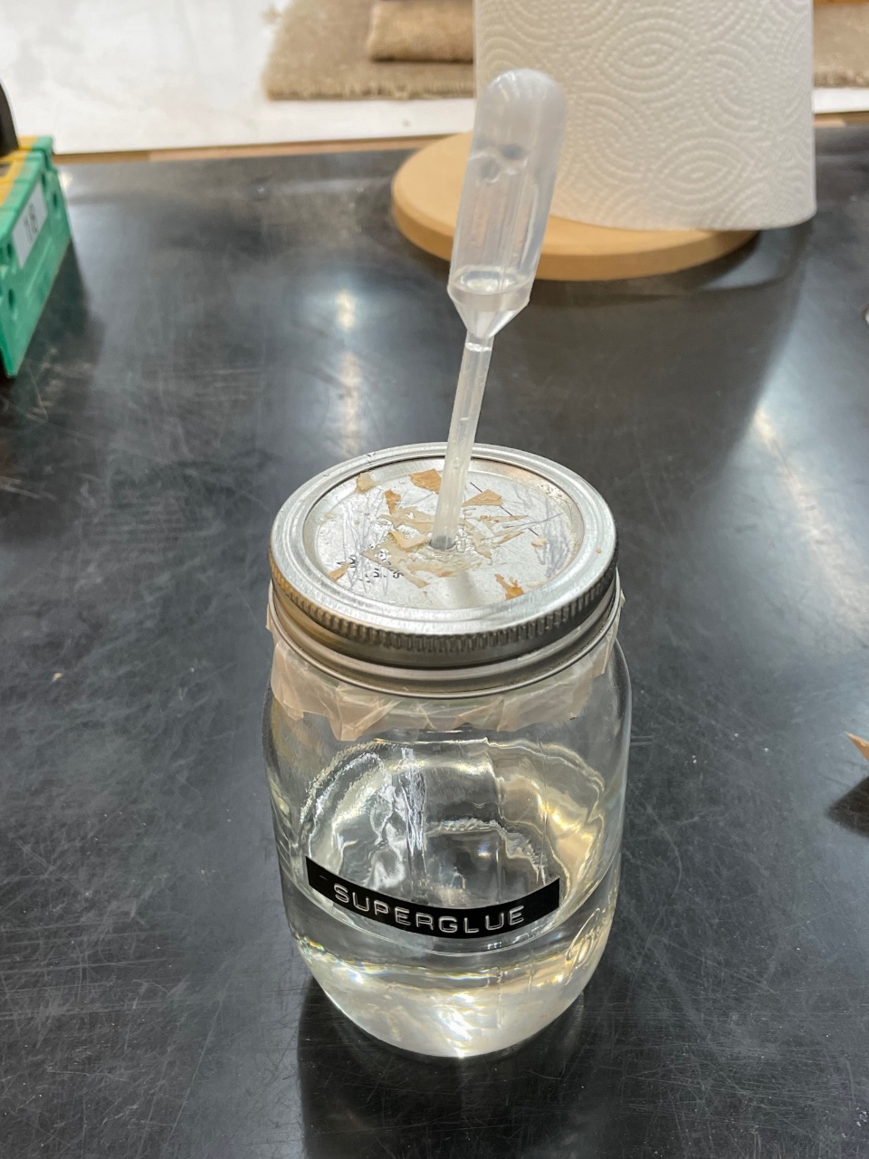

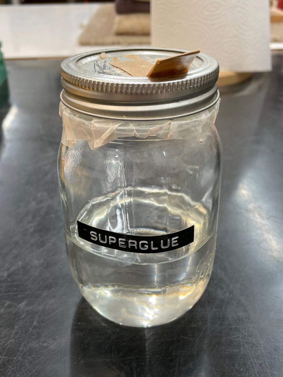

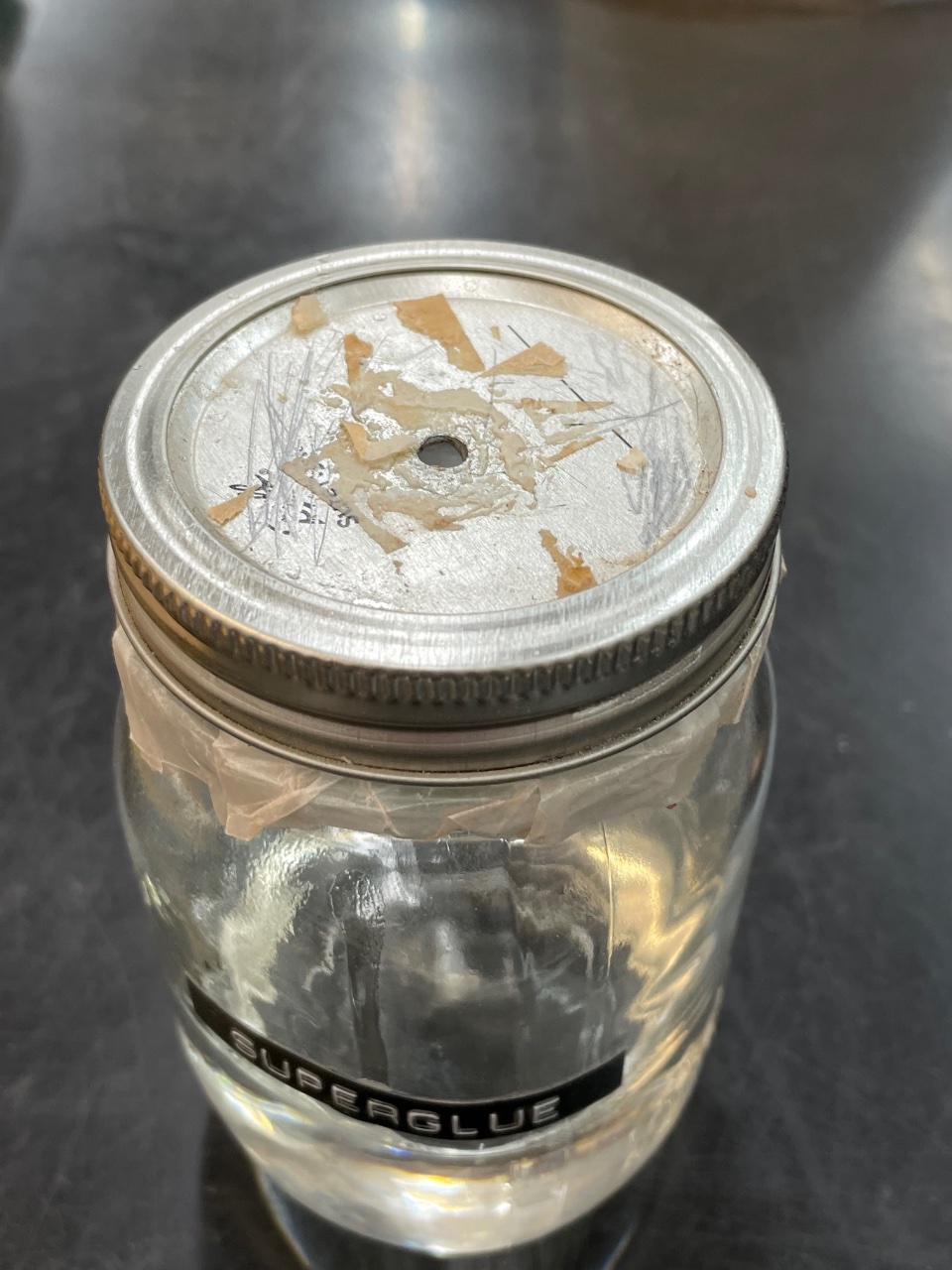

I buy super thin superglue from Starbond.com in 16 oz bottles. I then transfer the contents to a mason jar with a hole drilled in the top just bigger than my stew Mac pipettes. I seal the top with wax paper and then screw the lid down tight. When not in use the top is covered with a piece of heavy duty brown masking tape to seal the top and make it airtight. When I need to fill a pipette I just remove the tape, insert the pipette and draw glue into the pipette. When not in use, the pipette is saved upside down (tip up) and I find that glue remains usable for about three weeks. Here are photos of my setup.

Post by John Parchem » Sat Aug 28, 2021 9:53 am
Sylvan, That looks like a good way to store and dispense CA. I can count the number of times, I left the CA bottle uncapped and later knocked it over.
