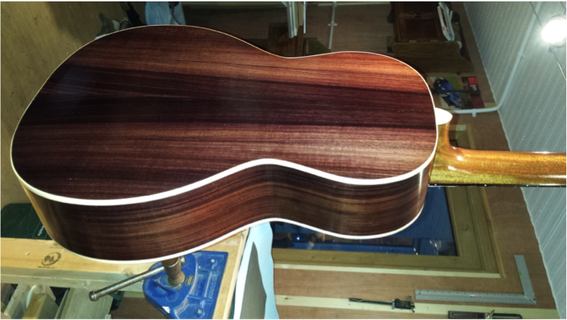

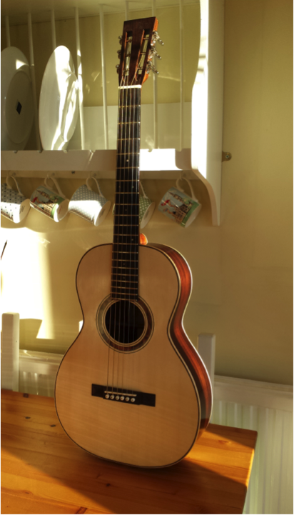

Here's a couple of pics. Not the best shots to show the finish but you get the idea...

Managed to sort it by editing my previous post. Pics are now on, they're not great photos but the back pic shows how well the TO brought out the colour.
Also I forgot to mention that I de-pitched the rosewood first in acetone which meant there was more red and less black in the wood. The amount of oil that comes out of the wood is unbelievable. This definitely improves the grain and colour of rosewood. Probably helps the glue joints too.
