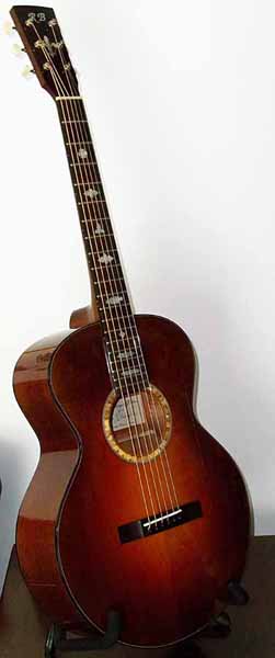

Re: moving from 14 to 12 fret neck joint?
Here is a Nick Lucas style base on the L-1 plans from LMI. It was completed and delivered in June. I used an X brace pattern, a 24 1/4 inch scale length and 13 frets to the body. It is a mahogany body and and Adirondack spruce top. I really like the results and am now building one with EIRW back and sides and a sitka spruce top.
- Finished full front s.jpg (29.68 KiB) Viewed 4233 times
