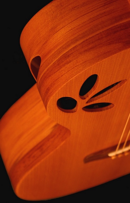

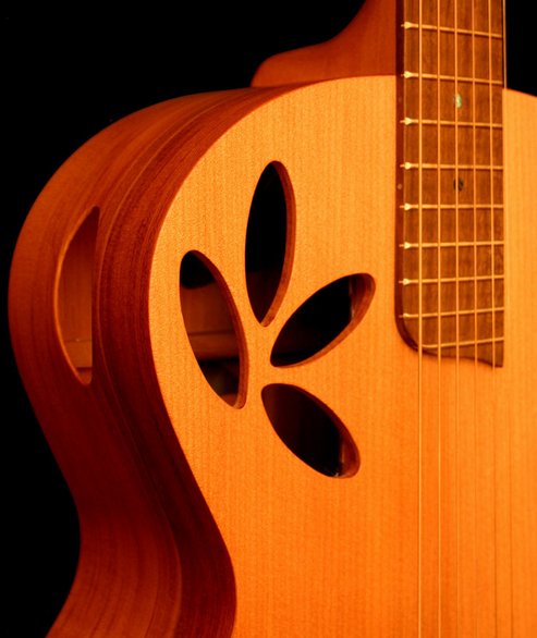

A pic of what got me started on the whole 'seamless' look.
- 7kauri.jpg (47.5 KiB) Viewed 4096 times
- 8kauri.jpg (72.68 KiB) Viewed 4098 times

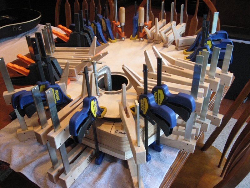

Dave, I'm not sure how your seams match on your glues up but I think that is more important than the rounding (or how you do it) of the top and back. Here's a pic of what I do to be sure there is a gapless seam around the entire top and back. And since this shot I've added 6 more cam clamps to fill spots and make reaching around the mold easier. I know some will be HORRIFIED at the number I use. But that's OK - no gaps. (Sorry for the edits)
- 8 Top glue up.jpg (268.18 KiB) Viewed 4095 times

Tim - 'no gaps' being the task at hand, your method is logical and works, what more can a fella ask for?
What IS horrifying is finding gaps after the glue-up. :-(
