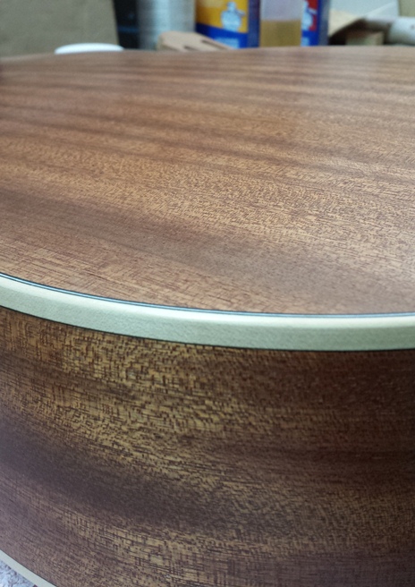

I think I have the back pore filled using the sawdust and shellac method. Pretty easy really, but it can make a gooey mess too if too much shellac is used, I've found.
I have some shellac on the sides, so they will be next. The neck is now not attached so I will do it last I think, pore filling and finishing.
- 20150310_071628.jpg (137.56 KiB) Viewed 2290 times
That pore fill looks good!
Yeah so far so good!
