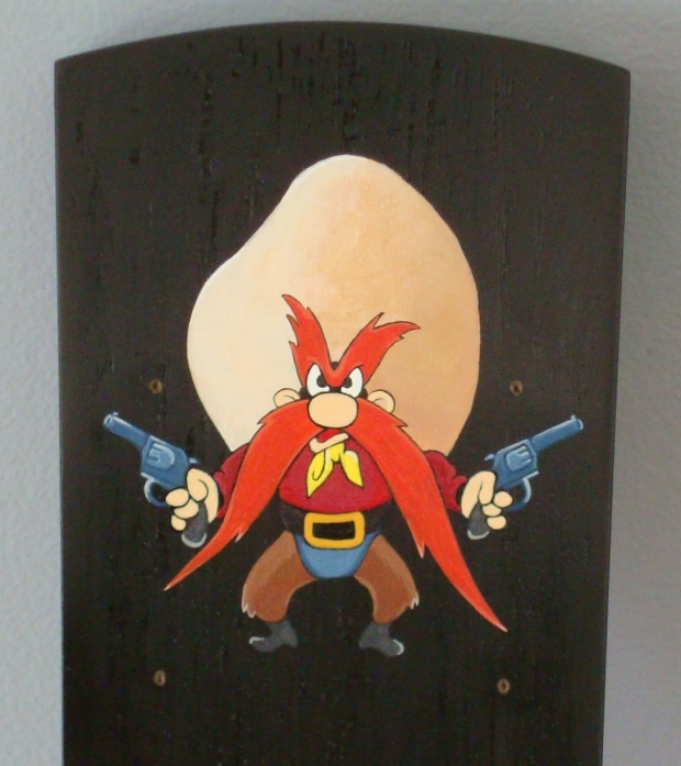

I have no experience with true oil but I use Krylon Crystal Clear to protect acrylic art on my guitars and water slide decals on model airplanes. It's a fixative for the decoration that allows me to spray lacquer over the art. Otherwise the lacquer "eats" the decoration.
